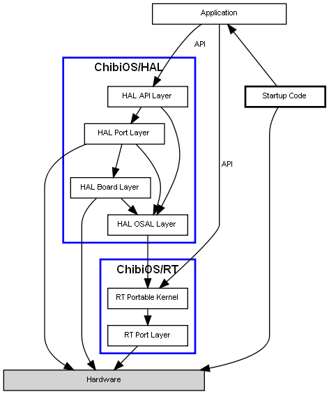

The Big Picture
The ChibiOS system is strongly layered, the structure is always the same regardless of the target architecture:
The various elements will be described in greater details in next chapters, this is a brief description:
Startup Code
It is the code executed after the reset. The startup code is responsible for:
- Core initialization.
- Stacks initialization.
- C Runtime initialization.
- Calling the main() function.
In ChibiOS the startup code is provided with the OS and is located under ./os/common/startup for the various supported architectures and compilers, scatter files and everything else is required for system startup are also provided.
Application
It is the user code, ChibiOS provides a simple template of main() function, everything else starts from there.
ChibiOS/RT
This is the RT scheduler kernel which is divided in two internal layers:
- RT Portable Kernel. It is the part of the RTOS kernel which is architecture and compiler independent. The RT code is located under
./os/rt. - RT Port Layer. It is the part of the RTOS kernel specific for one architecture and one or more compilers. The RT port code is located under
./os/common/ports.
ChibiOS/HAL
HAL is the acronym for Hardware Abstraction Layer, a set of device drivers for the peripherals most commonly found in micro-controllers. The HAL is split in several layers:
- HAL API Layer. This layer contains a series of portable device drivers. The HAL portable code is located under
./os/hal. HAL Port Layer. This is the device driver implementations for a specific micro-controller or family of micro-controllers. The HAL port code is located under./os/hal/ports.- HAL Board Layer. This module contains all details of a specific board mounting the micro-controller. Board level initialization is performed in this module. The HAL boards code is located under
./os/hal/boards. - HAL OSAL Layer. This is the Operating System Abstraction Layer. The HAL has to use some RTOS services in order to implement its functionality. The access to the RTOS services is done through this abstraction layer in order to not lock the HAL to a specific RTOS. The HAL OSAL code is located under
./os/hal/osal.
Considerations
Note that in the above architecture it is clear that RT does not need HAL and can be used alone if HAL is not required. On the other hand, in this architecture HAL uses RT's services through the OSAL but it could use another RTOS or even work without RTOS by implementing an OSAL over the bare metal machine. The examples in this book will cover RT and HAL both together and alone.
