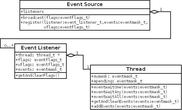

There are several classes of objects involved in events handling: Event Sources, Event Listeners, Event Flags and threads themselves.
Event Sources
Event Sources are the objects that broadcast events to system.
There are two possible operations on event sources:
- Register. Registering on a source causes the thread to be notified of events.
- Broadcast. Broadcasting a source notifies all threads registered on the source that an event occurred.
Event Flags
Events also carry information, the information is encoded as Event Flags, a mask of flags of type eventflags_t are broadcasted by sources together with the event itself.
For example, an event source is associated to a serial driver in order to signal events on the line, the flags represent the line condition: data transmitted, data received, parity error, framing error etc. Basically, the event itself just says that something happened, the associated flags indicate what happened, the reason for the event.
Event Listeners
On each event source one or more event listeners can be registered, each event listener is linked to a single thread. The structure establish a many-to-many relationship between event sources and threads.
Event flags are ORed to the flags field of the event listener, the associates thread can retrieve them using chEvtGetAndClearFlags().
Events Masks
A set of pending events at thread level is called an Events Mask and has type eventmask_t, this type has must not be confused with event flags. Each thread has two fields related to events handling:
- ewmask, is the mask of events the thread is interested in, an AND is performed between this mask and the mask of the pending events.
- epending, is the mask of the events waiting to be served by the thread.
