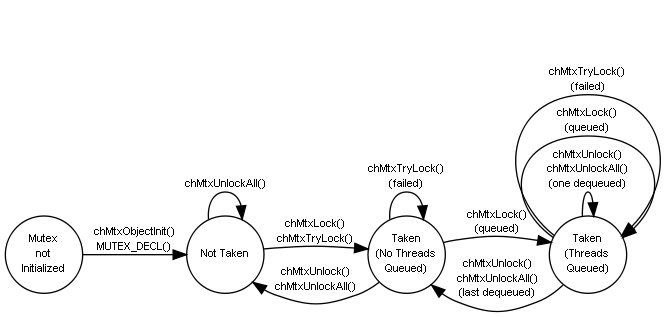

State Diagram
Mutexes and Threads
There is a strict relationship between mutexes and threads:
Each mutex has a reference to the owner thread and a queue of waiting threads, on the other side, threads have a stack of owned mutexes. The field cnt counts how many times the owner has taken the mutex, this is present only if the recursive mode is enabled.

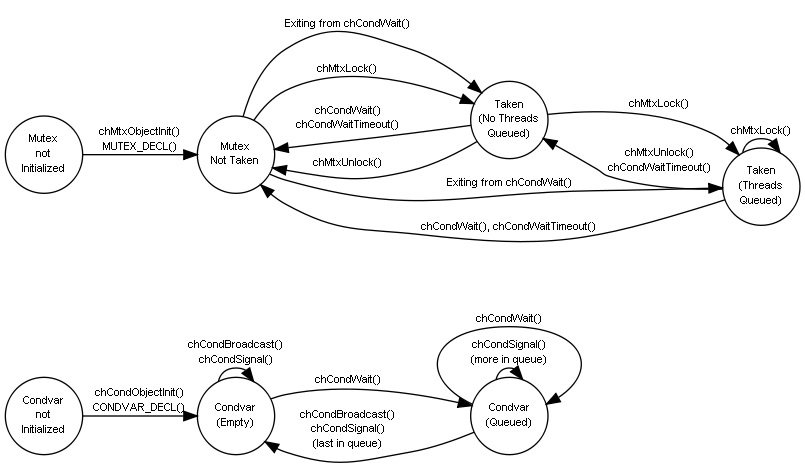

State Diagram
Condition variables and mutexes, together, are regulated by the following state diagrams:
Note how that the chCondWait() function implicitly operates on the last taken mutexes.
