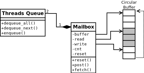

Buffer
Mailbox objects have an associated circular buffer of messages, usually an array of msg_t, the mailbox can be filled up to the buffer capacity, further attempt at posting new data will result in the thread waiting for a message slot to become free.
Internally, two thread queues are used for threads waiting to write or read the mailbox.

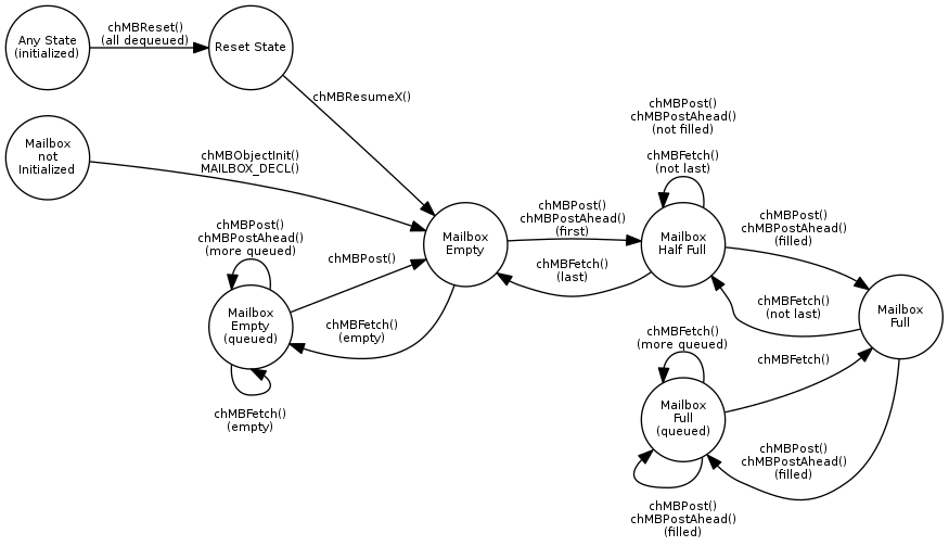

The Reset State
After resetting a mailbox using chMBReset() the mailbox enters a permanent reset state, any attempt to access the mailbox will result in a MSG_RESET return code.
The reset state can be exited by explicitly calling chMBResumeX() on the mailbox object.
