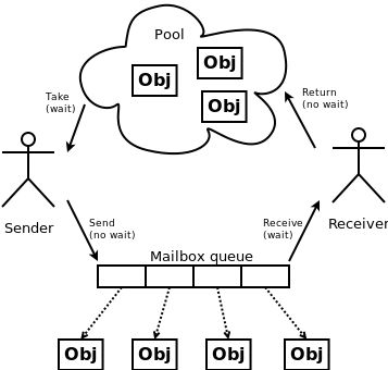

Objects FIFOs implements in an elegant way a simple use case, sending fixed-size objects from one end to another of a FIFO.
- No dynamic allocation.
- Copy-less operations.
- Able to work from thread and/or ISR context.
The Objects FIFO
This object is an aggregation of two other objects present in OSLIB:
- A guarded pool allocator, used for storing the objects to be transferred.
- A mailbox as FIFO structure.
Operations
Four basic operations are defined:
- Take, allocates an object from the guarded pool, waiting if an object is not yet available.
- Send, sends the allocated object through the mailbox.
- Receive, receives an object from the mailbox.
- Return, returns a received object from the pool.
Note that the pool and the mailbox have the same size so can accommodate the same number of objects, this means:
- Take can wait if the guarded pool is currently empty (or fail if called from an ISR where it is not possible to wait).
- Send never waits because there is always enough space in the mailbox by design.
- Receive can wait if the mailbox is empty (or fail if called from an ISR where it is not possible to wait).
- Return never waits by design.
Also note that objects are not copied into the mailbox, the mailbox just transports a pointer to the object, the object itself is static, it does not move.
