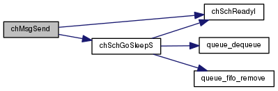

msg_t chMsgSend ( thread_t tp,
msg_t  msg
Sends a message to the specified thread.
The sender is stopped until the receiver executes a chMsgRelease()after receiving the message.
Parameters
[in]tpthe pointer to the thread
[in]msgthe message
Returns
The answer message from chMsgRelease().
Definition at line 87 of file chmsg.c.
References CH_STATE_SNDMSGQ, CH_STATE_WTMSG, chDbgCheck, chSchGoSleepS(), chSchReadyI(), chSysLock, chSysUnlock, currp, ch_thread::msgqueue, ch_thread::rdymsg, ch_thread::sentmsg, ch_thread::state, and ch_thread::u.

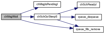

thread_t * chMsgWait ( void  )
Suspends the thread and waits for an incoming message.
Postcondition
After receiving a message the function chMsgGet() must be called in order to retrieve the message and then chMsgRelease() must be invoked in order to acknowledge the reception and send the answer.
If the message is a pointer then you can assume that the data pointed by the message is stable until you invoke chMsgRelease() because the sending thread is suspended until then.
The reference counter of the sender thread is not increased, the returned pointer is a temporary reference.
Returns
A pointer to the thread carrying the message.
Definition at line 121 of file chmsg.c.
References CH_STATE_SNDMSG, CH_STATE_WTMSG, chMsgIsPendingI(), chSchGoSleepS(), chSysLock, chSysUnlock, currp, queue_fifo_remove(), and ch_thread::state.
