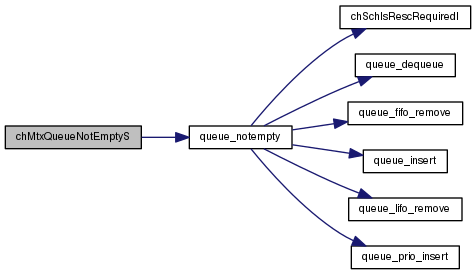

static bool chMtxQueueNotEmptyS ( mutex_t mp)
inlinestatic
Returns true if the mutex queue contains at least a waiting thread.
Parameters
[out]mppointer to a mutex_t structure
Returns
The mutex queue status.
Function Class:This is an S-Class API, this function can be invoked from within a system lock zone by threads only.
Definition at line 128 of file chmtx.h.
References ch_mutex::queue, and queue_notempty().
Referenced by chMtxUnlock(), chMtxUnlockAll(), chMtxUnlockAllS(), and chMtxUnlockS().
