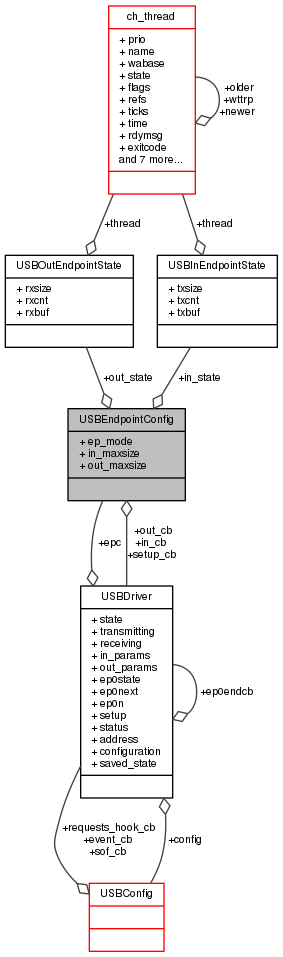

Collaboration diagram for USBEndpointConfig:
